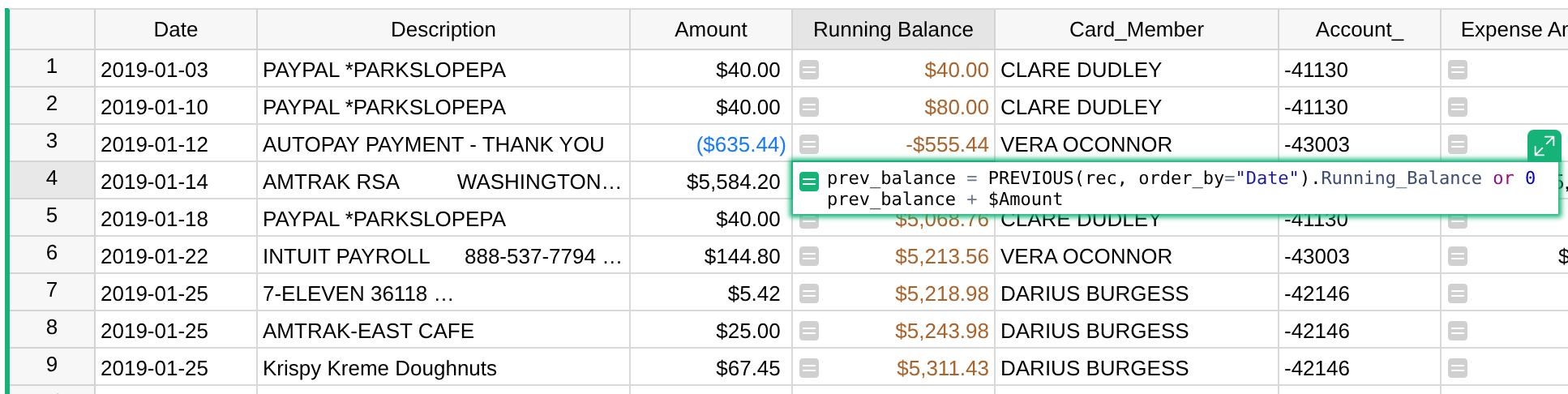

The Credit Card Activity example has a table of transactions with a Date and an Amount. To get a running balance, each record needs the balance from the record before it, plus its own amount. That’s the formula in the Running Balance column:
prev_balance = PREVIOUS(rec, order_by="Date").Running_Balance or 0
prev_balance + $Amount
running-balance-formula
Here’s what’s going on:
  • PREVIOUS(rec, order_by="Date") sorts the table by Date, finds where the current record (rec) falls, and returns the record just before it. Note that "Date" is the column’s ID in quotes, not $Date.
  • The result is a record, like a value in a Reference column, so you can use dot notation to get any field from it. Here, .Running_Balance is the balance of the previous transaction.
  • The first record has no previous record. PREVIOUS returns an empty record, and its Running Balance is empty. The or 0 turns that into zero, so that the addition works.
Numeric columns don’t need or 0
If the Running Balance column has the type Numeric, the empty record’s .Running_Balance is 0 rather than empty, so or 0 isn’t needed. If the column has the type Any, leaving out or 0 leads to an error like “TypeError: unsupported operand type(s) for +: ‘NoneType’ and ‘float’”.
Try sorting this table by Amount, or filtering it, or adding a page that shows the same data differently. The running balance stays the same in each record: it’s always the balance in Date order, because that’s what the formula says.

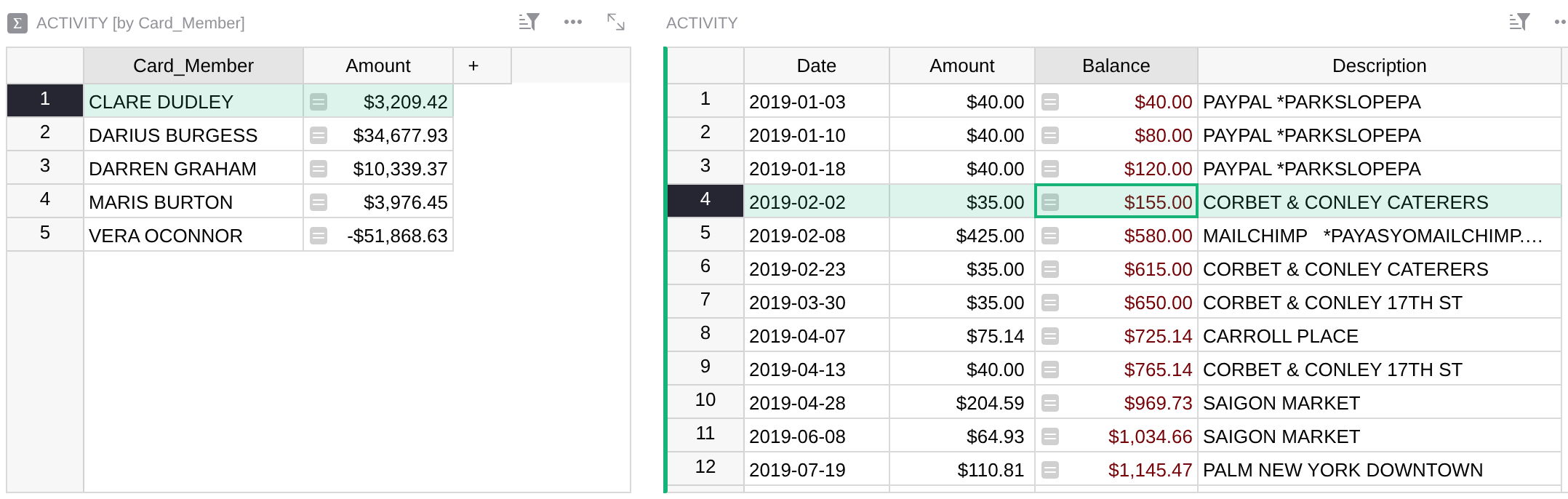

Transactions for different accounts, people, or categories belong in the same table. To keep a separate running balance for each, add group_by. The Credit Card example has a second running total, in a column named Balance, which keeps a separate balance for each card member:
prev_balance = PREVIOUS(rec, group_by="Card_Member", order_by="Date").Balance or 0
PREVIOUS now finds the previous record by Date among the records with the same Card_Member as the current one.
On the By Card Member page, selecting a card member shows just their transactions, and the Balance column adds up as you’d expect:
balance-by-member
Show each running total where it makes sense
A formula’s value doesn’t depend on the view. In a view with all card members, a per-member balance would jump between rows, because each row continues its own member’s total. In views of the whole table, show the overall running total. In views filtered or linked to one card member, show the per-member balance.

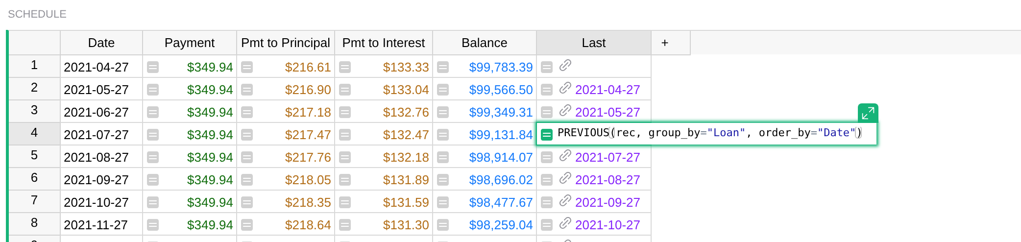

When several formulas need the previous record, it helps to put it in a column of its own. The Loan Tracker example computes a loan’s amortization schedule, where each payment’s interest and principal depend on the balance left after the previous payment. Its Schedule table has a column called Last, with the formula:
PREVIOUS(rec, group_by="Loan", order_by="Date")
The column type is set to Reference to the Schedule table itself, so each row points to the payment before it in the same loan:
loan-last-ref
Other formulas then use $Last like any reference. For example, this formula gives the starting principal in each payment row:
$Last.Outstanding_Principal if $Last else $Loan.Initial_Amount
For the first payment of a loan, $Last is empty, so the formula falls back to the loan’s initial amount.

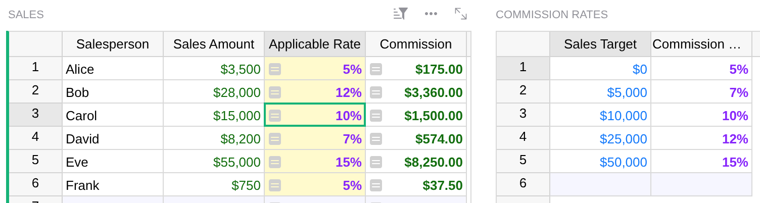

Dates are common, but anything that can be sorted works. The Sales Commissions example has a table of tiers, where reaching each Sales Target earns a higher Commission Rate. To find the rate for each salesperson:
rates = Commission_Rates.lookupRecords(order_by="Sales_Target")
rates.find.le($Sales_Amount).Commission_Rate
lookupRecords with no field arguments returns all records of the table, here sorted by Sales Target. For Carol’s $15,000 in sales, the last tier at or below that amount is $10,000, so her rate is 10%:
commission-find-le
