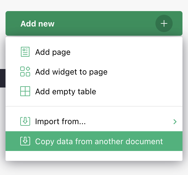

Begin the copy process by clicking the “Add New” button and choosing “Copy data from another document”.
add-new-menu-doc

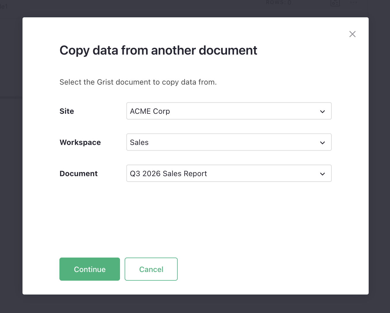

Then, select the site, workspace, and document you would like to copy from and click “Continue”.
copy-data-select-doc

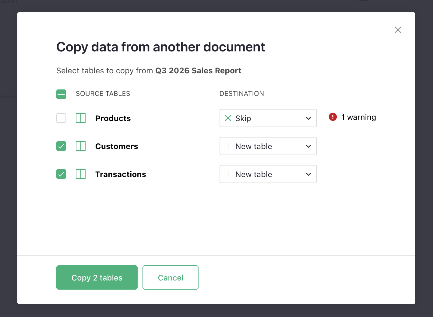

You will then see a list of all the tables contained within that document. For each table, you can choose to:
  • Create a new table: This will create a new table, and copy all data into it.
  • Create a new table (structure only): This will create a new table that matches the structure of the one in the source document, but will not copy any data.
  • Copy into an existing table: When copying within an existing document, you can choose one of its tables as the destination. Columns are matched by ID, and records that were previously copied from the same source table matching the “Source Row Id” column are updated in-place, rather than duplicated.
  • Skip the table: Skips the table entirely. If you have any other tables containing references to this table, those references will not be copied.
copy-data-select-tables
During configuration, you may see warnings next to some tables. These warnings let you know if there are any differences you might notice in your data after the copy is complete.
Finally, click “Copy tables” to execute the copy process. Stay on the page until the copy finishes. Once the transfer is complete, your newly created tables will appear in the destination document.
