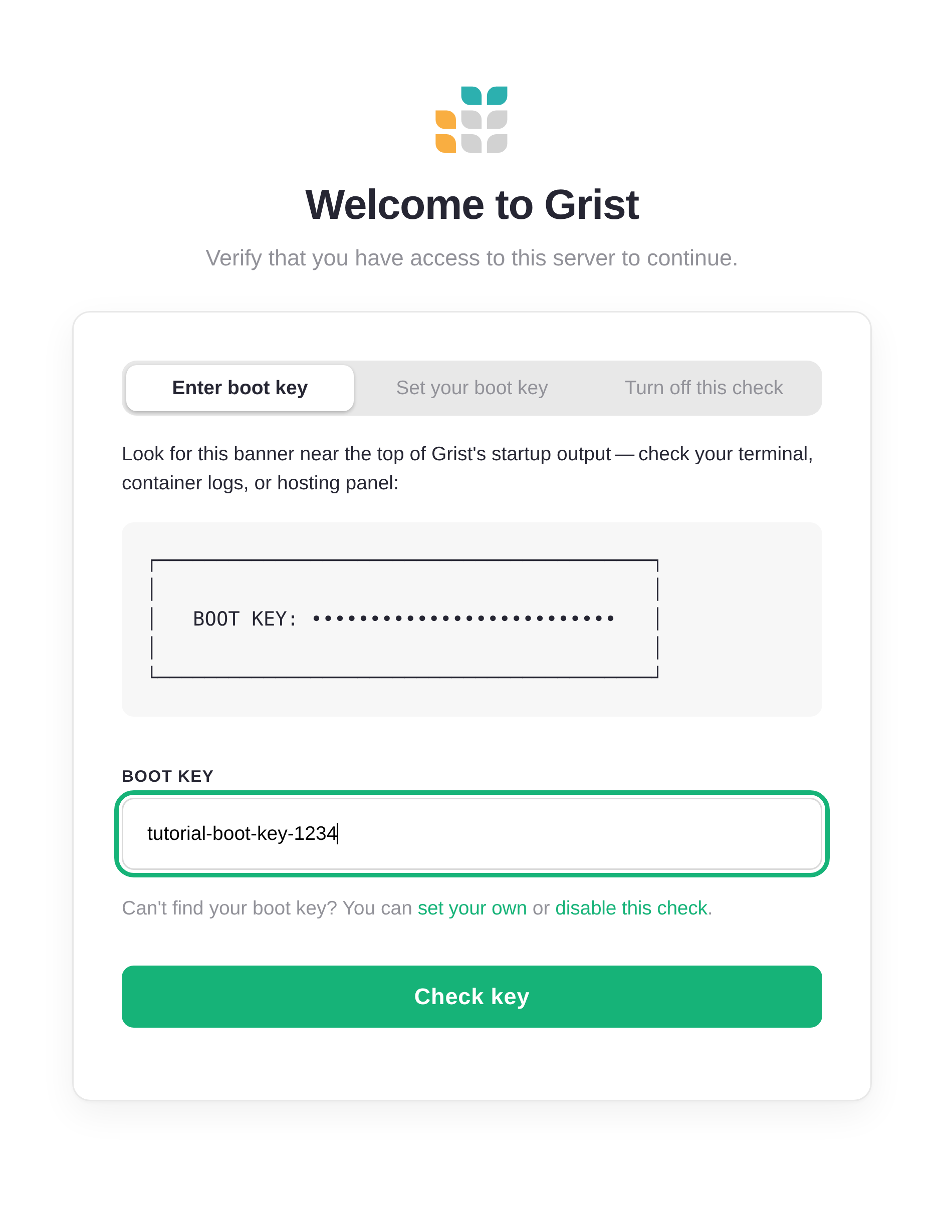

Open a fresh Grist install in a browser and you’ll land on the welcome page. No sign-in form, no documents, just a card asking for a boot key.
Welcome to Grist
It only appears once. Grist wants proof that whoever is reaching the web app also has access to the machine running it, not just anyone who happens to find the URL. The boot key is that proof.

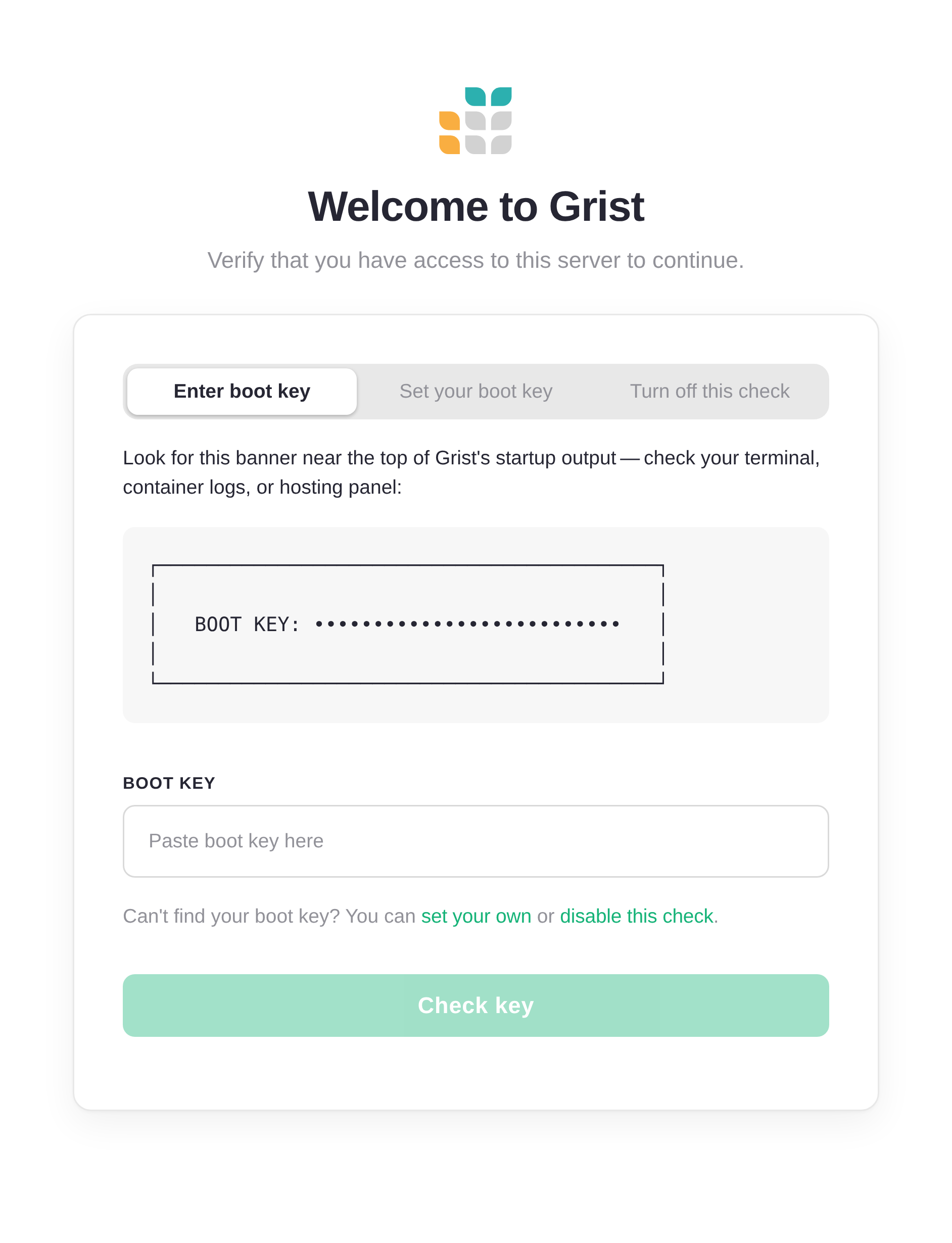

Grist prints the key into its own startup output. Check your terminal, container logs, or hosting panel for a banner that looks like this:
│   BOOT KEY: ••••••••••••••••••••••••••   │
│   Use this key at /boot to sign in.      │
Paste that key into the field and click ‘Check key’.
Boot key pasted

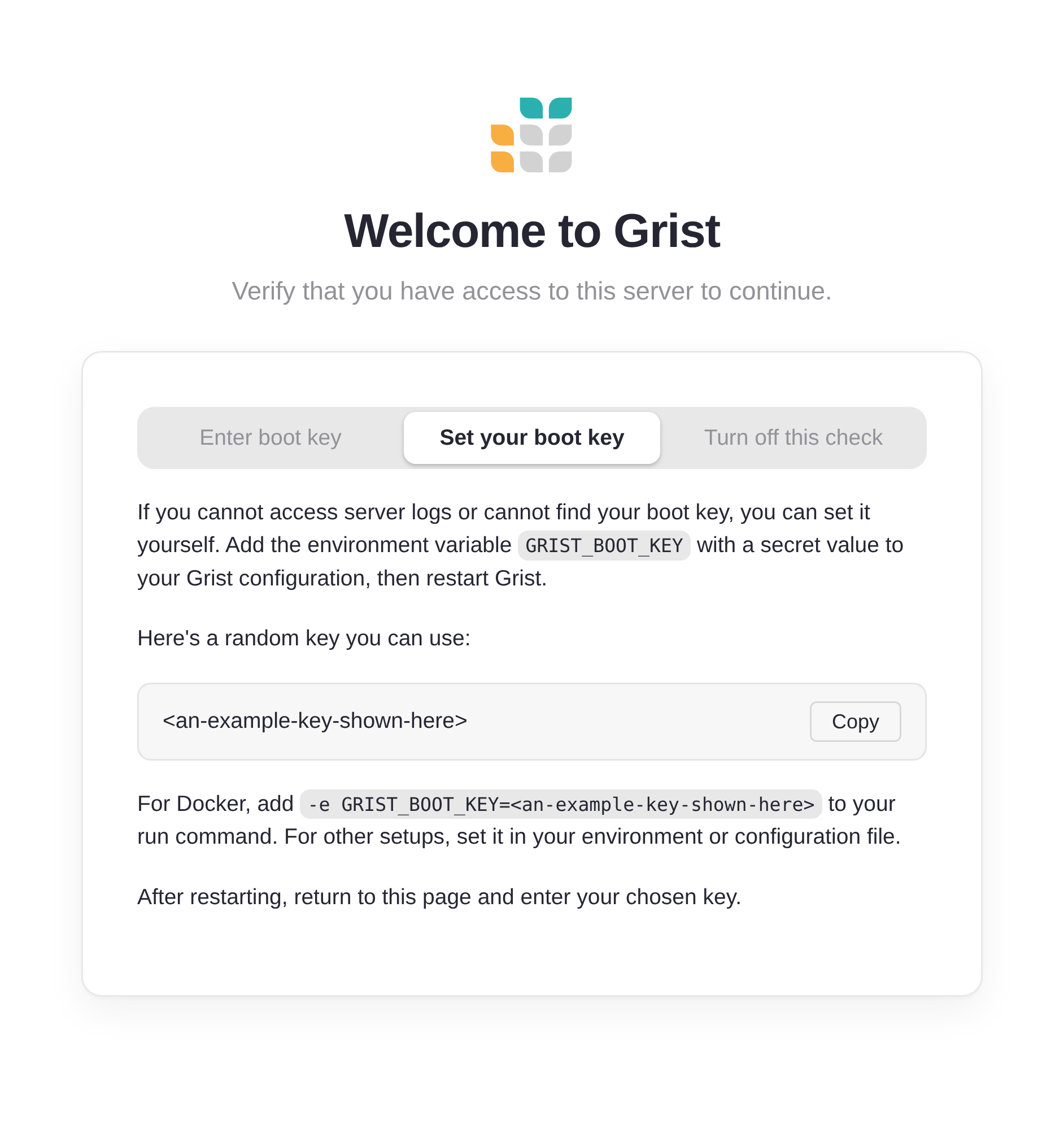

Can’t see the logs? Maybe Grist is running on a hosting provider that hides them, or in a container you didn’t start yourself. Switch to the ‘Set your boot key’ tab.
Set your boot key
Set the environment variable GRIST_BOOT_KEY to a secret value of your choice, restart Grist, then return to this page and use your new key. For Docker, that means adding -e GRIST_BOOT_KEY=<your-secret> to your run command.

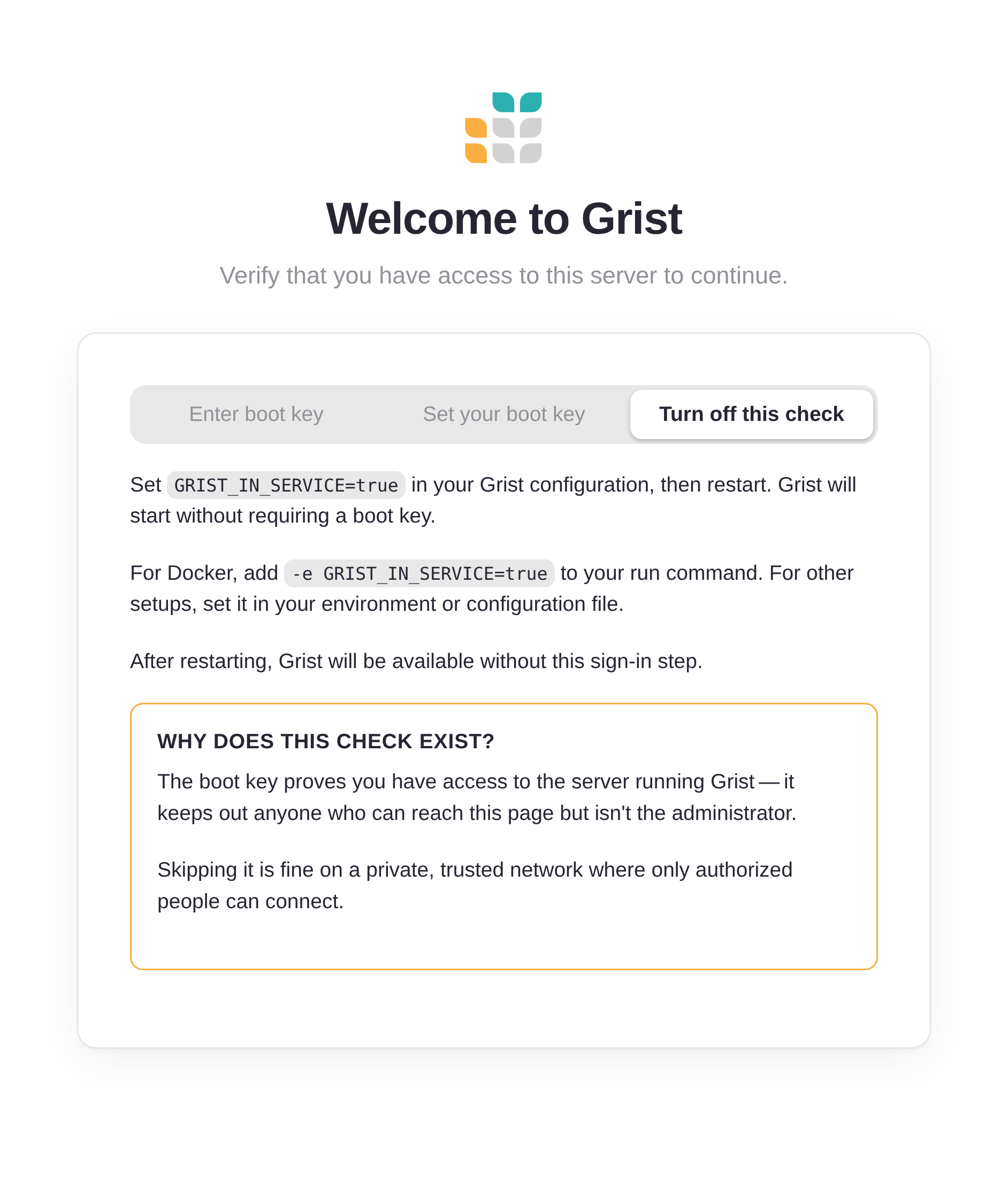

Turn off the boot check#
If your server lives on a private, trusted network where only authorized people can reach it, the boot check is overkill. Switch to the ‘Turn off this check’ tab.
Turn off this check
Set GRIST_IN_SERVICE=true and restart. Grist skips the check entirely.
Why the check exists
The boot key proves you have access to the server running Grist. It keeps out anyone who can reach this page but isn’t the administrator. Skipping it is fine on a private, trusted network.

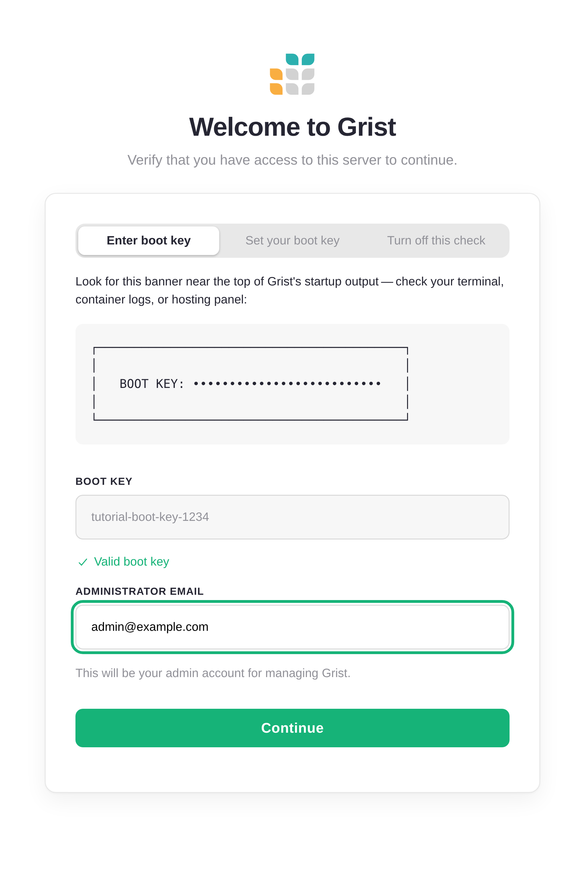

Set the administrator email#
Once Grist accepts your boot key, it asks one more thing: what email address should belong to the administrator account?
Confirm admin email
This email becomes the owner of the installation. If GRIST_ADMIN_EMAIL was set when Grist started, you’ll see it pre-filled and can adjust it. If not, type the one you’ll sign in with.
Click ‘Continue’. Grist hands you off to the Quick setup wizard.

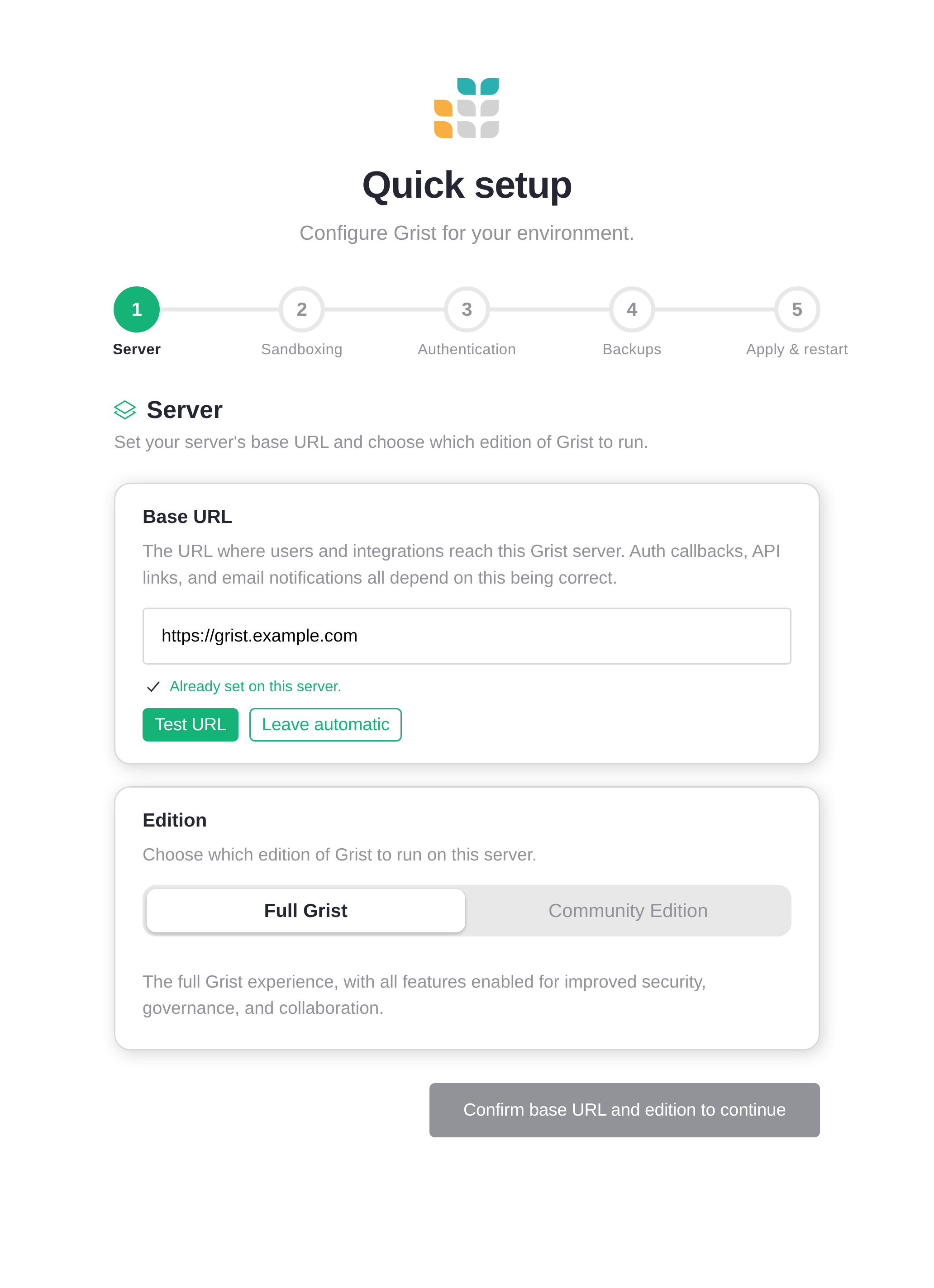

Quick setup, step 1: Server
Step 1: Server#
Two settings: the base URL Grist should use for itself, and which edition to run.
The base URL matters more than it looks. Auth callbacks, share links, and email notifications all build their URLs from it. If you’re behind a reverse proxy or HTTPS terminator, set it to the public URL users will type, not the internal one. Click ‘Test URL’ to have Grist sanity-check the value.
The ‘Edition’ toggle picks between the licensed full edition of Grist and the free Grist Community edition. See the edition comparison for the difference.

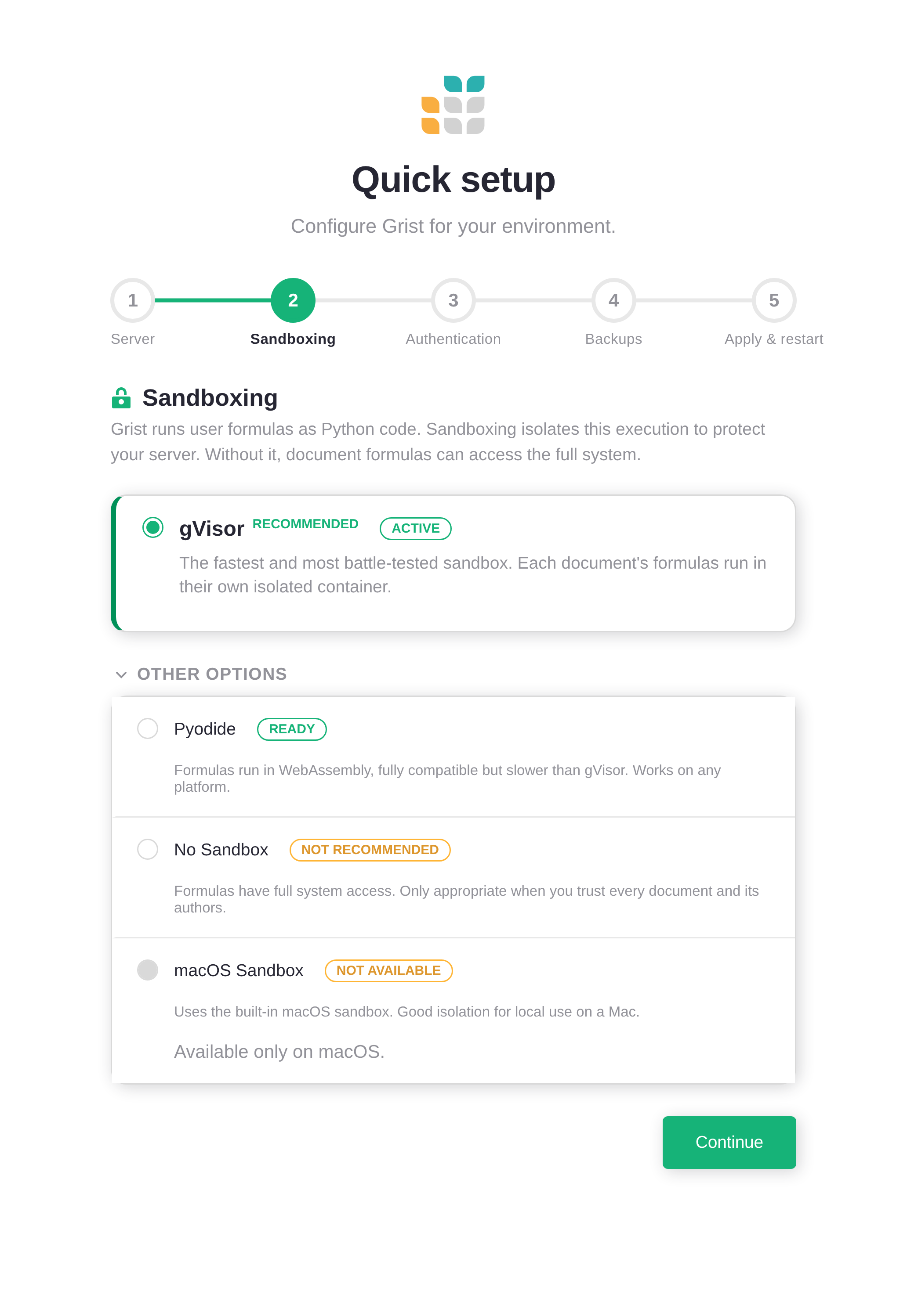

Step 2: Sandboxing#
Grist runs user-written Python formulas. Without a sandbox, those formulas can read and write anything the Grist process can access. Any server hosting documents from more than one author should have the sandbox enabled.
Quick setup, step 2: Sandboxing
The wizard probes the host and grays out anything that isn’t available. On Linux, gVisor is the recommended choice. Pyodide runs formulas in WebAssembly: slower, but portable.
Already set in the environment?
If GRIST_SANDBOX_FLAVOR is already set when Grist starts, the wizard shows the current value and locks the field. To change it, edit your environment and restart.

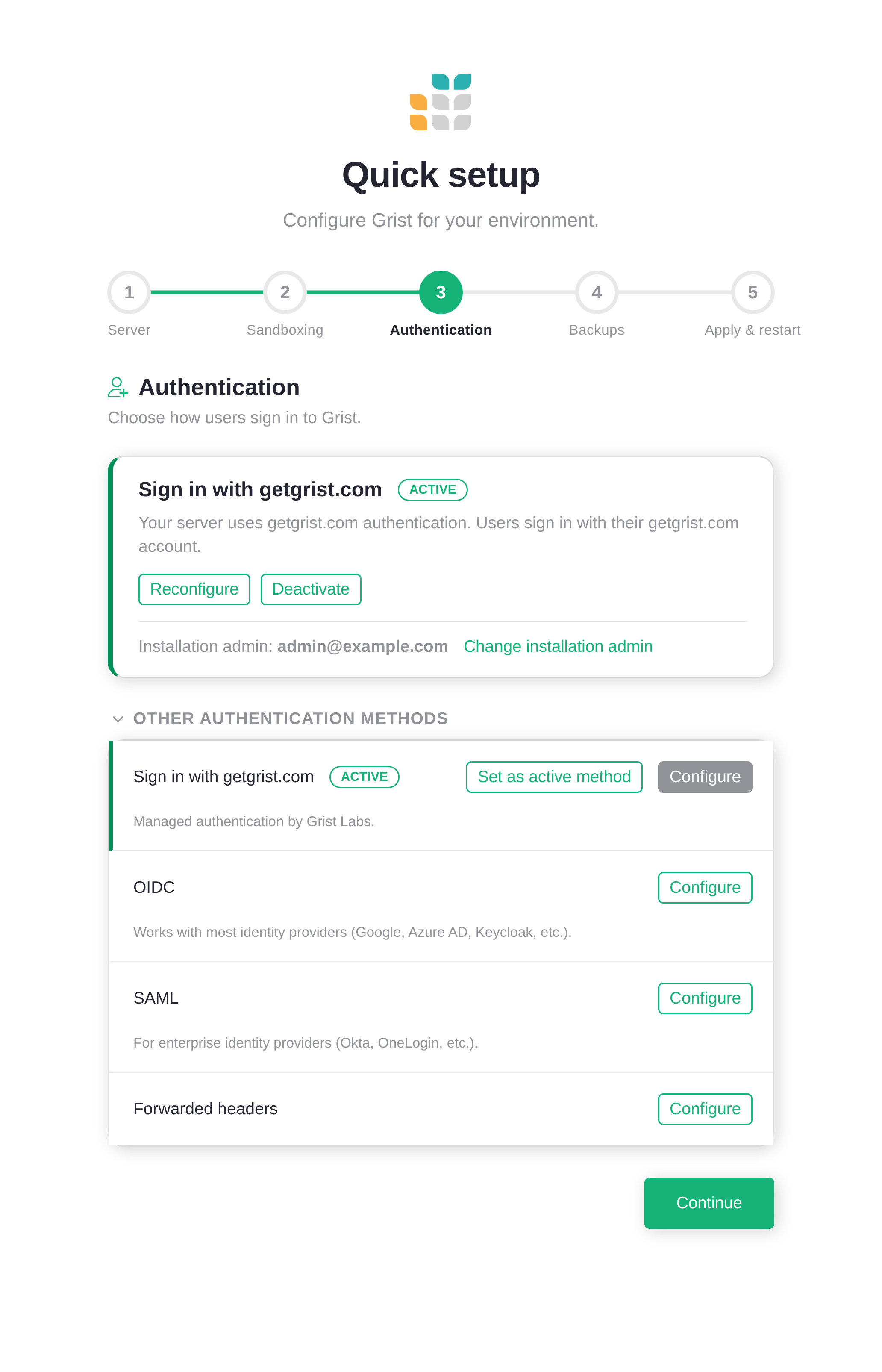

Step 3: Authentication#
This is the step that matters most for a public-facing server. Initially, a fresh Grist installation has no authentication. Anyone who reaches it can read and edit documents.
Quick setup, step 3: Authentication
See Authentication overview for the full list and guidance on which to pick:
  • Sign in with getgrist.com: managed auth by Grist Labs. Quickest to set up.
  • OIDC: works with Google, Okta, Auth0, Keycloak, and most other identity providers. Requires an activation key.
  • SAML: for enterprise SSO. Requires an activation key.
  • Forwarded headers: when an upstream proxy already authenticated the user.
If you really do want an open server, say, a personal install on your laptop, pick No authentication (the bottom-most option) and confirm.

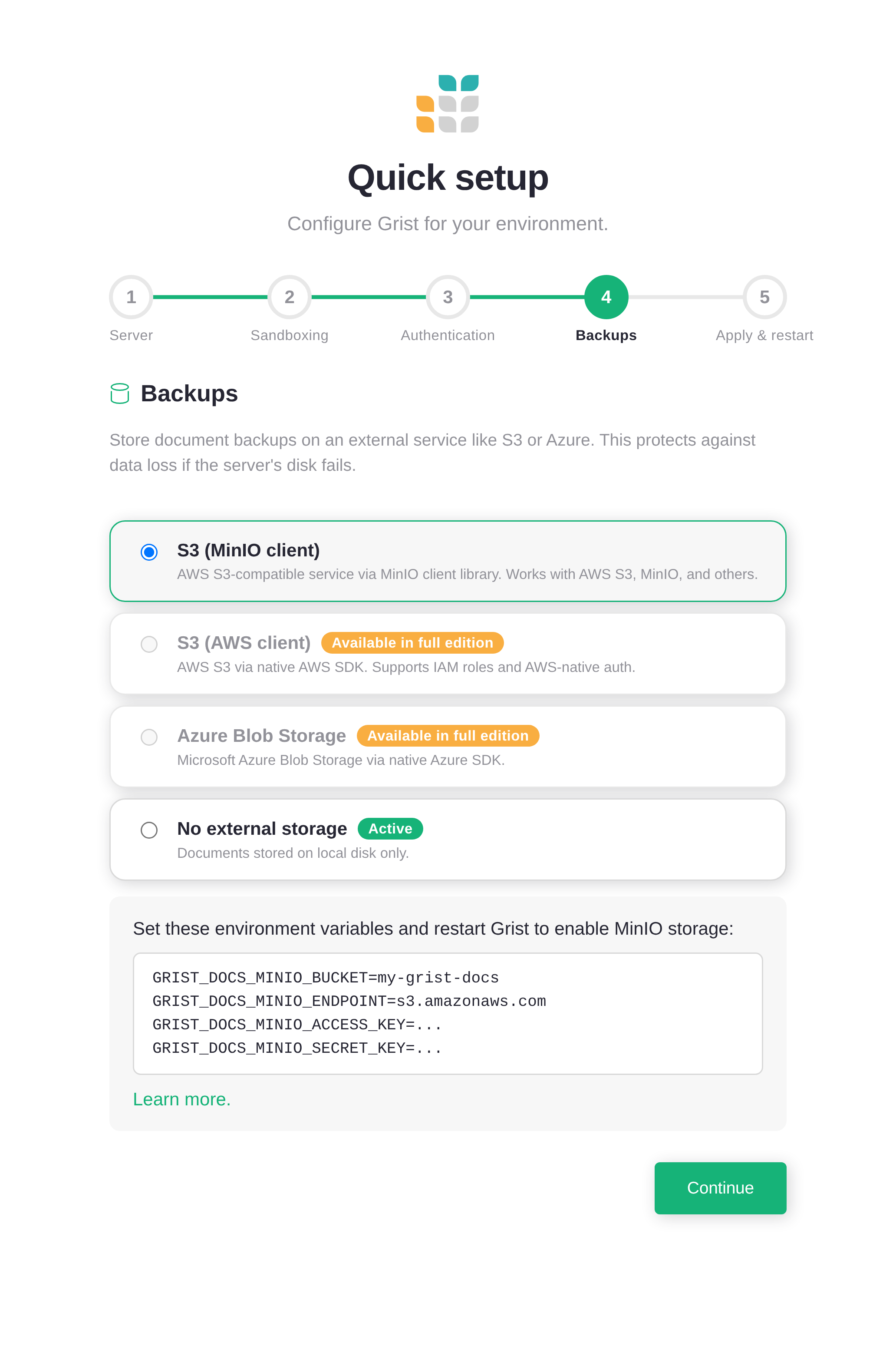

Step 4: Backups#
Grist documents are SQLite files on disk. If the disk fails, they’re gone. Hooking up external object storage gives you off-host backups automatically.
Quick setup, step 4: Backups
You can pick S3, an S3-compatible service like MinIO, or Azure Blob Storage, or skip this step and configure it later from the Admin Panel. See Cloud storage for the full setup details.

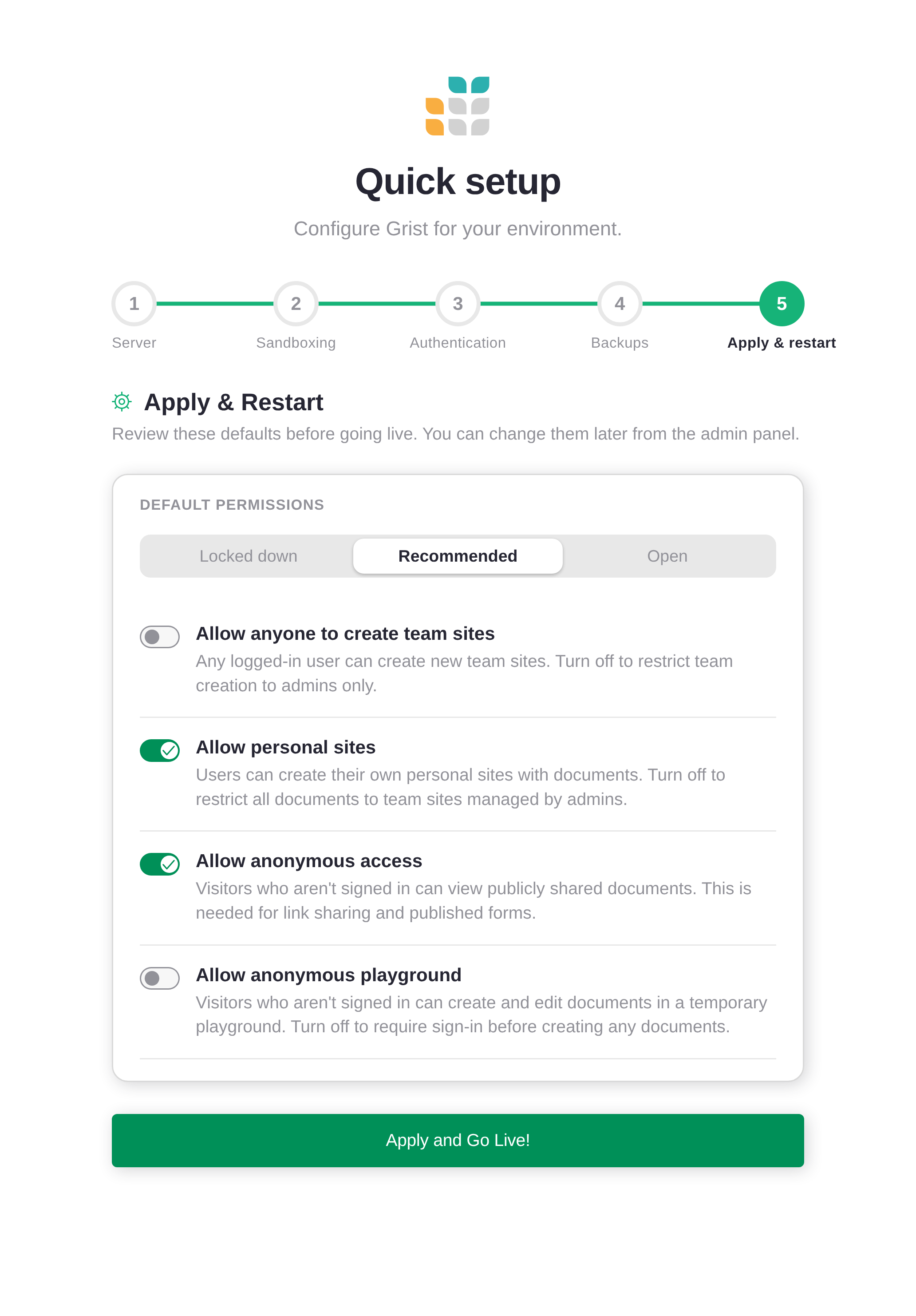

Step 5: Apply and restart#
The last step shows four install-wide permission switches and three presets.
Quick setup, step 5: Apply and restart
The presets do most of the thinking:
  • Locked down: only admins create sites, no anonymous access. Pick this for a single-team, behind-the-firewall install.
  • Recommended: personal sites and anonymous viewing on, team-site creation off, no anonymous playground. This is the default.
  • Open: everything on. Useful for a public, low-stakes server (and not much else).
The toggles, in plain English:
  • Allow anyone to create team sites. If on, any signed-in user can spin up a new team site. Most installs want this off so admins control the team list. Backed by GRIST_ORG_CREATION_ANYONE.
  • Allow personal sites. Each user gets their own private workspace. Off means every document lives in an admin-managed team site. Backed by GRIST_PERSONAL_ORGS.
  • Allow anonymous access. Required for public link sharing and published forms. Off means users have to sign in before they see anything. Backed by GRIST_FORCE_LOGIN (inverted).
  • Allow anonymous playground. Lets unauthenticated visitors poke at a throwaway document. Off if you’d rather not advertise that affordance. Backed by GRIST_ANON_PLAYGROUND.
